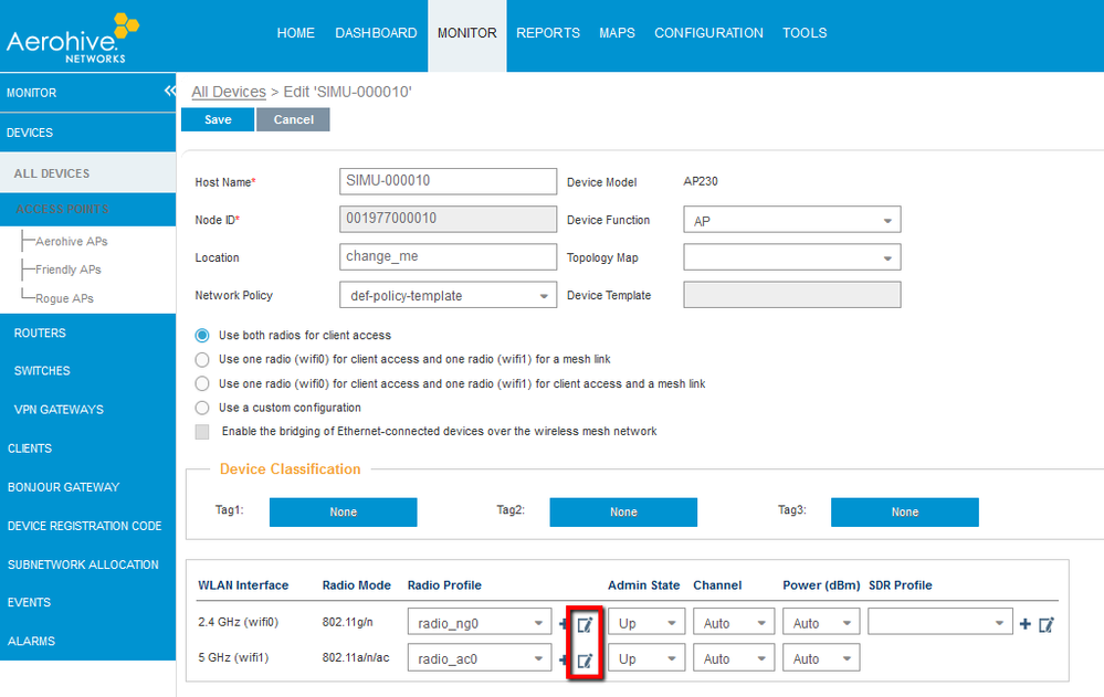

Thank you for letting me know. To edit the Radio Profile in use currently, you'll want to go to Monitor> Check the box next to the AP> Modify> Click the edit button next to the Radio Profile.
Expand the Channel and Power section> at the end of this section you can set the Channel width to 20MHz.
Please note if you're using default Radio Profiles, you won't be able to make any changes to the default object. In this case, you'll want to go to Configuration> Expand the left hand side menu> Radio Profiles (left hand side menu)> Check the box next to the profile you are currently using> Clone. This will copy all of your current settings, and create a new object that you are able to make changes to.
