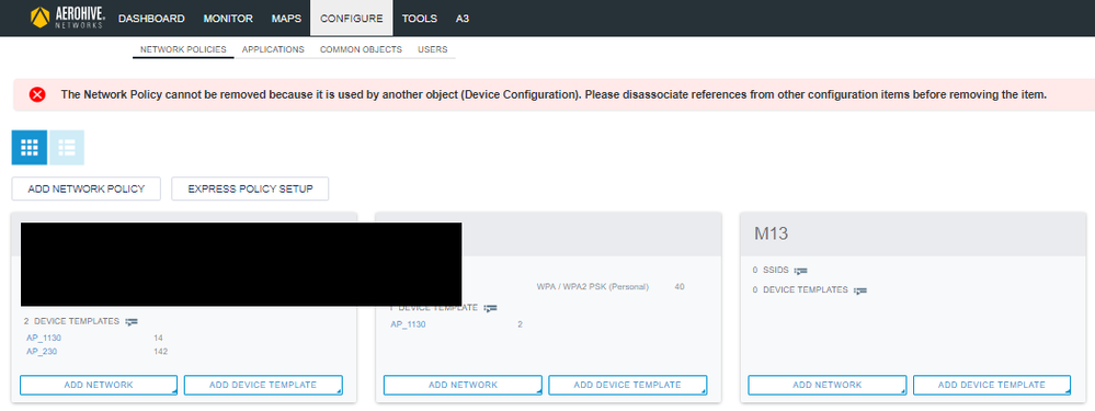

Hi Team,
I try to remove network policy in Hivemanager. When I try to remove the policy following error pop up.
"The Network Policy cannot be removed because it is used by another object (Device Configuration). Please disassociate references from other configuration items before removing the item."
Please do find the attachment also

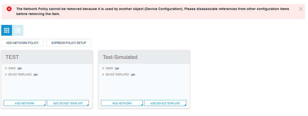

‎10-24-2018 11:34 PM
I'm facing the same issue with an identical message and cannot figure it out. I don't have any devices attached to the policy as far as I can say. Any help will be appreciated. I'm attaching my screenshot but can provide any other information needed. Thank you.
