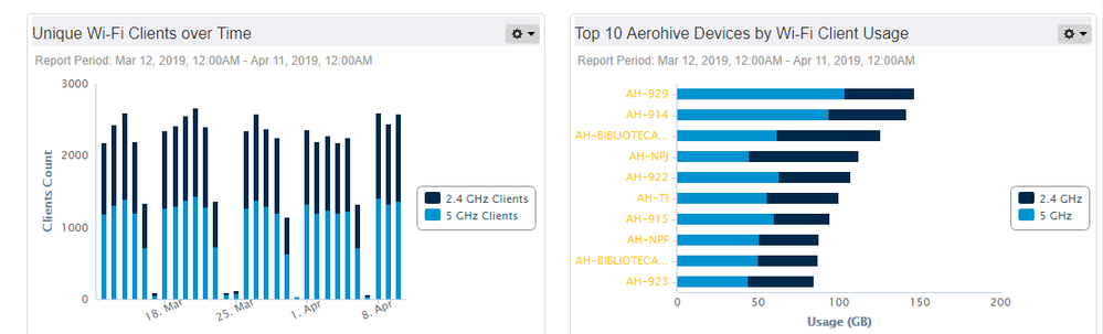

2ea3d080fb4042cd89df60ec90115542_0690c000007spR3AAI.pngwe are also a community university with about 700 simutaneous accesses, in my case this change to force the devices to connect in 5 GHz was faulted about 15 days approximately and the reason that started this connection problem.
I made the change so that the AP will encourage the connection at 5 GHz and no longer force it. I also did the activation of the Enable client load balancing among neighboring hive members. for APs.
