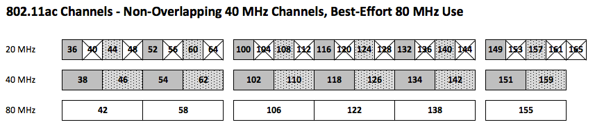

Just something to be aware of:
80MHz has 6 non overlapping channels (including 1 in the UNII3 band)
40MHz has 12 non overlapping channels (including 2 in the UNII3 band)1a1560eda74442399645f967bfdfdcbf_0694Q000009I2AEQA0.png

Channel or channel width?
2.4GHz - I'd use channels 1,6 or 11 as they don't overlap and keep at 20MHz width as generally the 2.4GHz is pretty noisy with neighboring APs (though deployment dependant of course, I'm just speaking generally).
5GHz - Enable DFS if not in a RADAR area (i.e. near an airport for instance), UNII-3 band use depends if using a limited tx power is fine for the deployment or not. 40MHz channel widths are usually fine.
You can use the command "show acsp neighbor" to see surrounding APs with the channels and channel widths being used.
