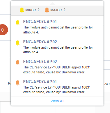

After I add rule for following service "YoutubeM" and try to add update with Delta configuration device update get failed.
When I check the alarms it showed followings
What is reason for getting above error ?

It seems after I update the AP122 to golden version, issue got rectify

Following messages are also appearing
The CLI 'service L7-GIPHY app-id 1451' execute failed, cause by: Unknown error
The CLI 'service L7-QUIC app-id 1676' execute failed, cause by: Unknown error

Following Major alarms are coming when we add the VPN application to IP firewall. I checked for few applications
The CLI 'service L7-ONAVOEXT app-id 1616' execute failed, cause by: Unknown error
The CLI 'service L7-DOTVPN app-id 1408' execute failed,
The CLI 'service L7-LINKVPN app-id 1556' execute failed, cause by: Unknown error
The CLI 'service L7-TURBOVPN app-id 1791' execute failed, cause by: Unknown error
The CLI 'service L7-TUNLBEAR app-id 1790' execute failed, cause by: Unknown error
The CLI 'service L7-BROWSEC app-id 1329' execute failed, cause by: Unknown error.....

Even for complete update I do get above error
CLI command failed:^Mservice L7-YOUTUBEM app-id 1883^Mip-policy SM id 21 service L7-
