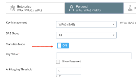

Hi Markus, I heard back from our engineering team on this and they recommended enabling WPA3, and then turning on Transition mode.
This Transition Mode will offer WPA3, but if that isn't compatible with the end user client device, then it will switch to WPA2.
Here is a clipping from the Wifi alliance reviewing this feature, in case you're interested:
WPA3-SAE Transition Mode
ā¢ When WPA2-PSK and WPA3-SAE are configured on the same BSS (mixed mode), PMF shall be set to capable (MFPC bit shall be set to 1, and MFPR bit shall be set to 0 in the RSN Capabilities field in the RSNE transmitted by the AP)
ā¢ When WPA2-PSK and WPA3-SAE are configured on the same BSS (mixed mode), the AP shall reject an association for SAE if PMF is not negotiated for that association
ā¢ A WPA3-SAE STA shall negotiate PMF when associating to an AP using WPA3-SAE Transition Mode
