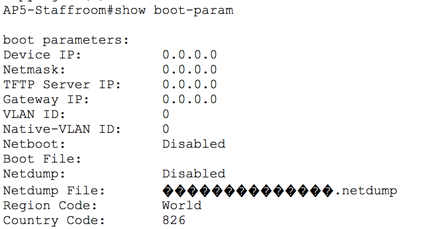

Nathan,
Here's what mine looks like:
AH-42db80#show boot-param
boot parameters:
Device IP: 0.0.0.0
Netmask: 0.0.0.0
TFTP Server IP: 0.0.0.0
Gateway IP: 0.0.0.0
VLAN ID: 0
Native-VLAN ID: 0
Netboot Always: Disabled
Netboot: Disabled
Boot File:
Netdump: Disabled
Netdump File: 02301407290864.netdump
Region Code: FCC
Country Code: 840
AH-42db80#
I'm unsure where those odd characters are coming from in the net dump file.
I'm also not up on the channels available per Country Code. But some quick searching should tell you the differences between the governing bodies allowable channels per region/country.
I am not able to change the country code on my APs anymore. The command boot-param country-code <number> used to work, but I believe Aerohive has disabled it from working so that folks didn't put their gear in the wrong country code a violate regulations and restrictions on channel sets. I am to understand that if Aerohive ships APs with the wrong country code, you would need to create a ticket with them and RMA them to get proper APs. But I would check with them or see if they can chime in here to confirm that. There'd be a slim chance you could change the country code from the GUI (varies depending on if you're using the legacy HM or not).

‎10-31-2018 08:34 PM
Also the options I get back are weird (see image), what could cause this?
