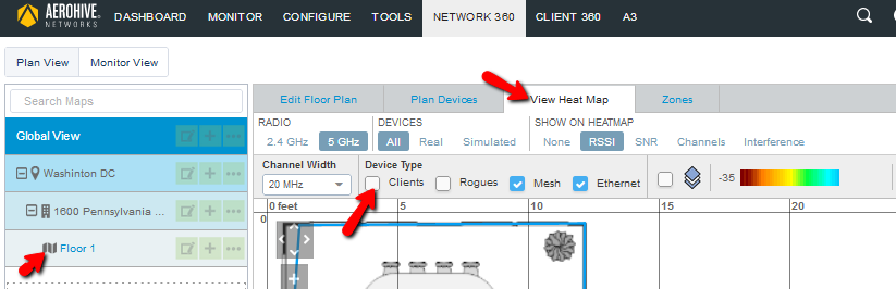

Thank you for your patience while I looked in to this. If you open a floor map, and go to View Heat Map, then check the box under Device Type for Clients, that should show connected clients on the map.
Is that what you were looking for?

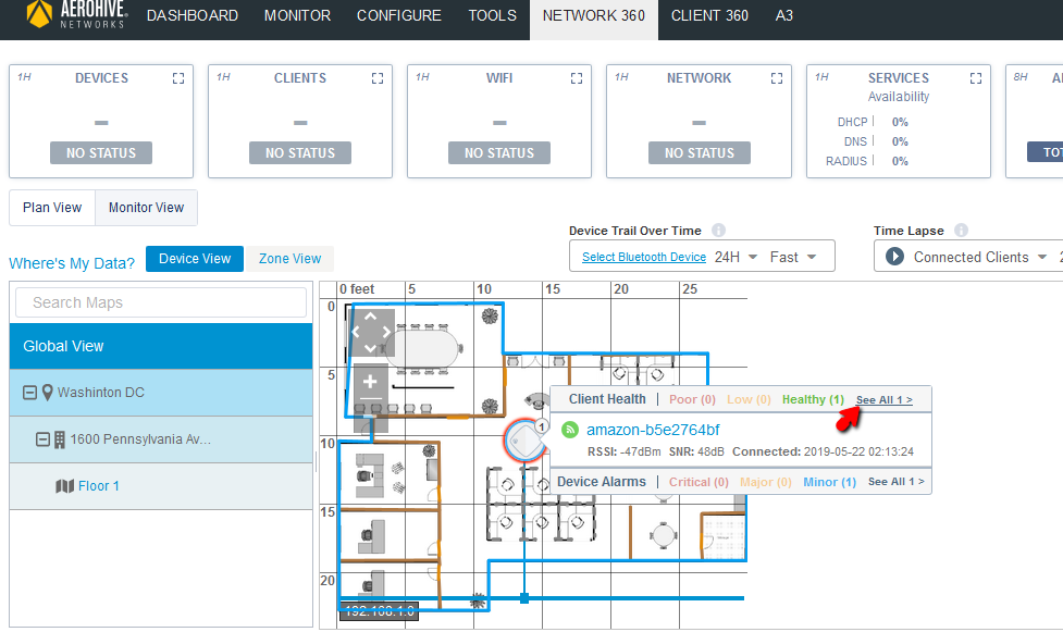

You'll want to look at the Monitor view within the Maps, and then click on the AP. A small information bubble will come up, which includes an option to See All clients connected. Is that what you were looking for?42c265f40c894e51862e7f7c0c7498e0_0690c000008OdYpAAK.png
