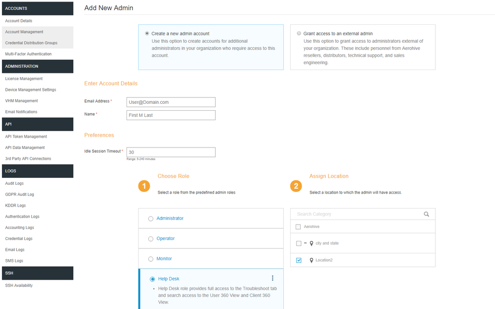

Hi guys! I need to create differentmanagement accounts and that every one of them could view and manage only certatin policies and APs. Is that possible?

Hello,
If you have your APs and devices segregated by Location, you can select which location any specific user has access to, and the type of user account they will have.
In the photo above, I've replicated adding a Help Desk User that can only manage Location2.
Hope this helps,

Great! Really helpful! So I need, mandatorily, to put each AP in a certain Location in order to apply this kind of rules of view per account.
Thanks David!! 
