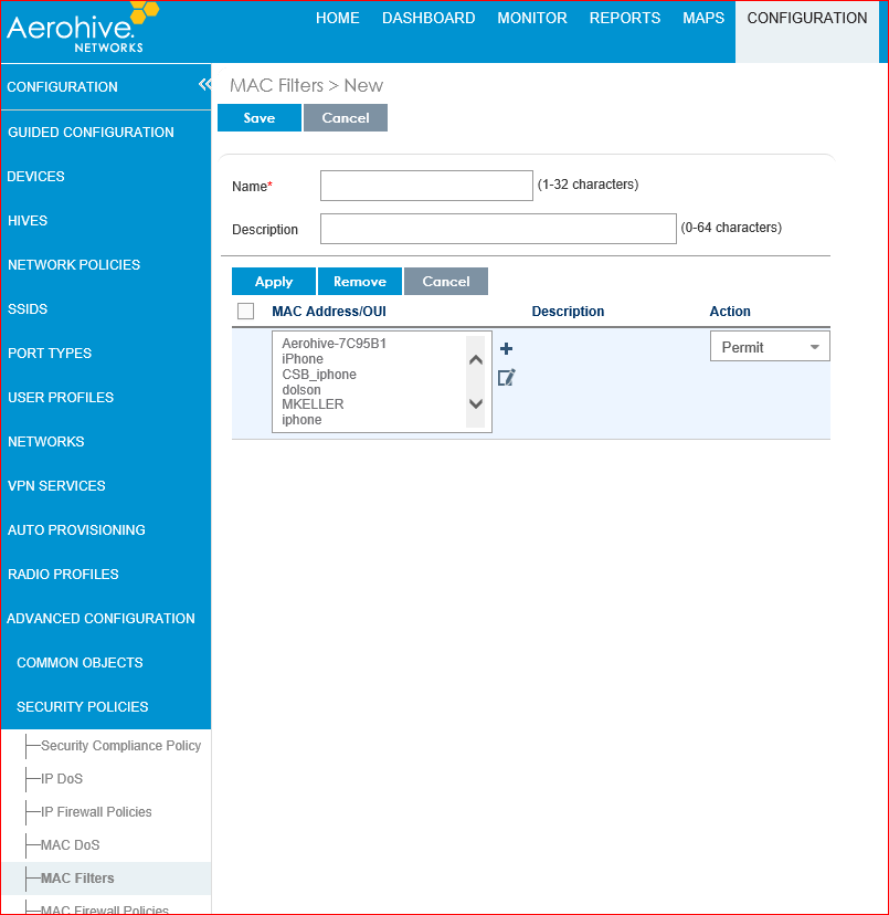

I am on 8.0r1 version.. My question is how do I delete a MAC OUI from the MAC filters ? EXAMPLE - Below I would like to delete CSB_iphone ????

You'd want to go one section above where you are (Common Objects) on the left hand side menu, then go in to MAC Objects. You should see CSB_iphone in here. You can delete the object on that page. If you just want to remove CSB_iphone from the filter, just highlight it and click remove at the top.

Thank you !!!
