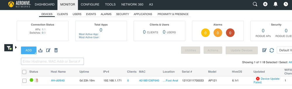

I created a new test account, once inside a policy and a location and purchased a new AP121 which I added in HiveManager. I don't see the SSID I created hence I can't use the AP. Why could that be?

Thank you BJ Stahlin. I'm totally lost here. The device does restart when I restart it from the cloud, so I guess the communication is working. Also it shows a white light. On the 2 error indicators (the "device Update Failed" and the red exclamation (!) mark next to the green hexagone, this is what I see. I do not understand which warnings are important or not. I'm a bit frustrated....

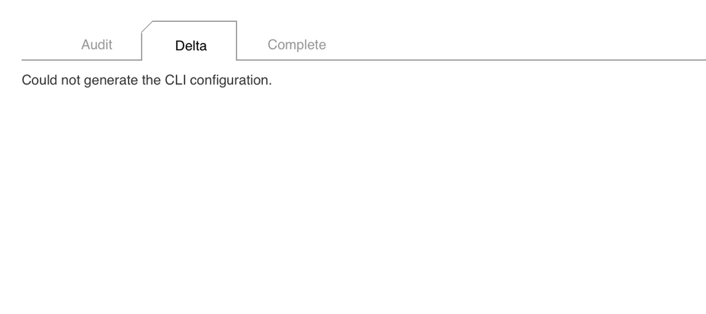

It appears the config was never successfully pushed, as noted by the failed update notification. This is usually due to loss of capwap between the device and HiveManager, which is either a result of a misconfig in the layer two (vlan) or three (ip/routing) configuration. If you roll over the failure notification, it might lead you toward a resolution. After you've identified and corrected the misconfiguration and a successful push, your AP should be operational.

This is what I see. Note it complains that "Device Update Failed"
