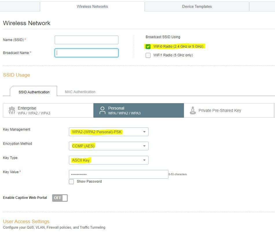

I have tried resetting the device to the default settings and have rebooted multiple times. With newer devices I can connect to both SSIDs. One strange thing is that on SSID A even though it is set for WPA2 it shows up as WPA which I do not want to use.
Thanks!
SSID A: (I hid the SSID Names)
SSID B: (I hid the SSID Names)

‎02-13-2020 10:12 PM
Okay, but shouldn't the WiFi0 Radio connect because it has WPA2? In addition, is it a best practice to have two separate SSIDs like this for better performance or should I just be using one SSID with both radios checked? Is there a link to the IQ Engine: 10.0r8?

‎02-13-2020 05:56 PM
Thank you for those screen shots. It looks like SSID B is using WPA3, which won't work with 10.0r7a. Could you try using WPA2? Also I might suggest updating to 10.0r8 as well.
