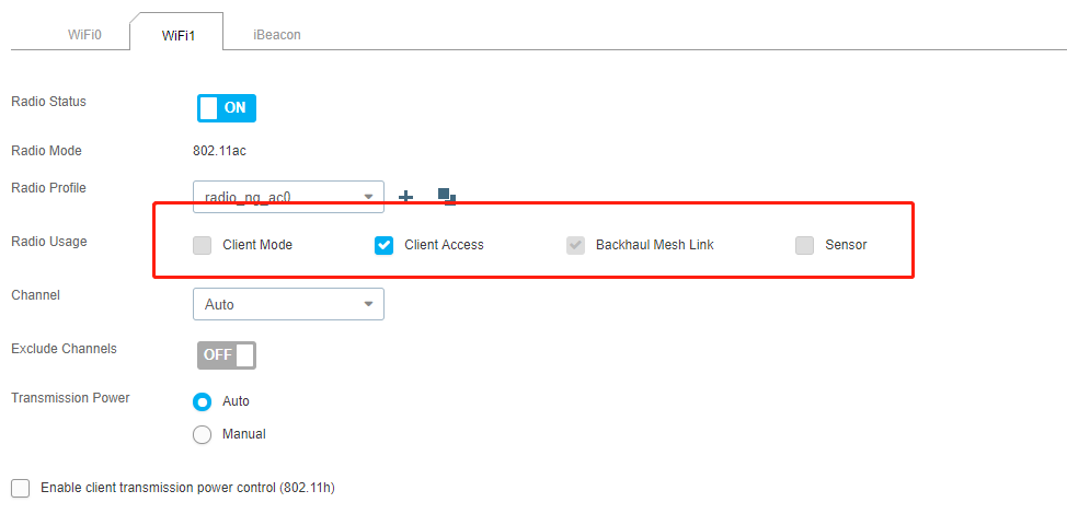

Thank you for letting me know, and for that screen shot. When we switch the ATOM to client mode, we are essentially asking it to perform as a client device rather than an access point, so it can connect as a client to the existing SSIDs. In this case, it would be expected for the AP to lock to client and mesh link mode. As for the eth0 port not functioning when in client mode, that is not expected behavior. You may need to open a case for that issue, the eth0 port should allow hardwired connections when the ATOM is in client mode.

When I choose the client mode int wifi0, the choice in the wifi1 only client access, the other choice can not click, also the wired interface disappear.
I followed Configure Client Mode APs Using Wired Template Provisioning,but not success.
The images are as follows.
Also, i want to know if there are any difference to configure the wired interface as a uplink port or access port when i configure ap as client mode. I have tried to configure this two type ports, but none of them can let me visit the web UI of the client mode AP
