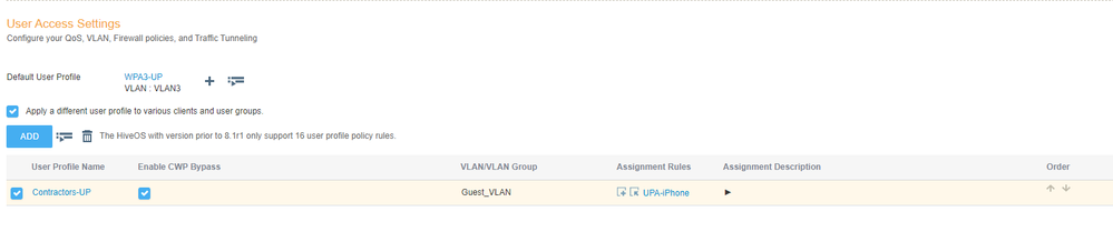

‎09-09-2019 09:20 AM
Presuming you're on HiveManager Select:
A CWP bypass within the user profile with an a MAC address assignment rule would work for this:
So you've got a user profile, enable/disable CWP bypass, then in the assignment rule you can add a list of MAC addresses that are allowed to skip.
Aside from users, it's a good way of getting IoT sort of devices onto the network when you've got a CWP in place also.
