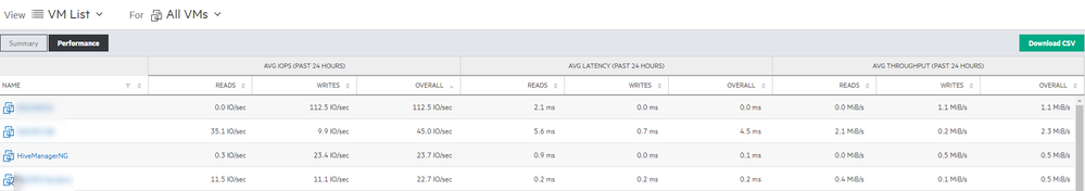

To ATAC, this is magically caused by HiveManager running on a SAN. What kind of logic is that? We run our VM infrastructure from a SAN with SSD caching and that thing is not a slouch. We have DB applications that run just fine with just as much I/O going on. It seems totally counterintuitive that they would just throw a blanket statement across anything they can't figure out as...."must be your SAN".
I've checked HiveManager's IOPS and majority of the hits are all SSD cache hits. It's also not our highest running VM in terms of storage hits.
