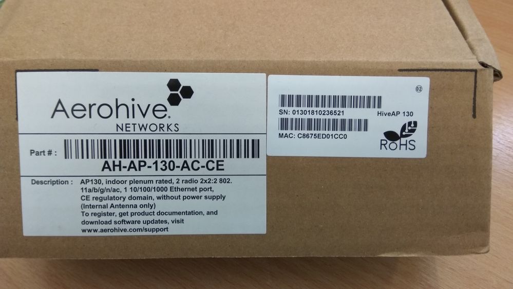

This is the correct MAC address (see image) and shows up on the system but does not get the config.

If you look closely, all of your other APs start with a different number. So maybe you didn't get the correct number off of the access point?

There is nothing about unknown SN from joining my HM
Please see attached picture
