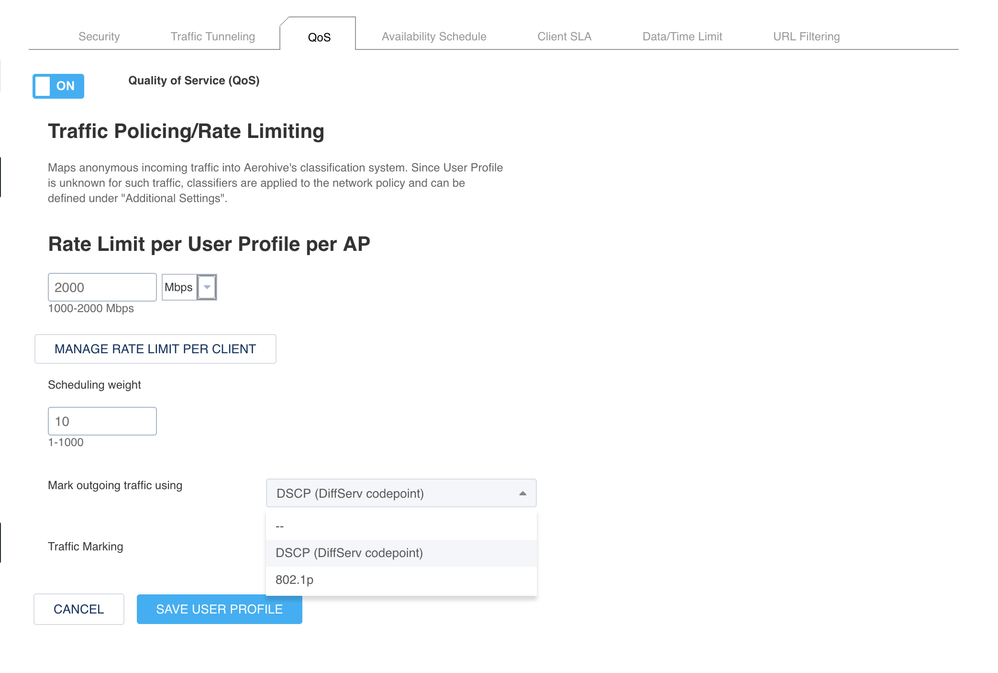

In the user profile we have 2 options for QoS: Traffic marking (with DiffServ or 802.1p)
or per user rate limiting with the use of WMM traffic queues.
If you aren't using DiffServe or 802.1p within your core network, enabling it at the edge won't help. This is why we suggest that you use the per user rate limiting taking into consideration your network design (LAN bandwidth on the wire side, I assume gigabit & WAN bandwidth from ISP). When there is a contingency for bandwidth the QoS will come into play and start prioritizing ingress/egress of video traffic.
You would find those settings by clicking on "Manage Rate Limit Per Client", you can see it in the last screen shot you shared.
jakub_sochacki
Hi Sam,
Could you explain a bit more how I would configure this in User Profile? The only options I see are DiffServ and 802.1p, but the traffic I am trying to classify is not tagged in this way. I would like to use the port ranges.
