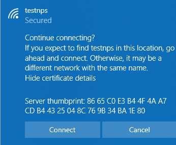

Switching NPS servers, On windows 10, when a user attaches to the new SSID they get a warning about the new network.
‎06-07-2019 07:48 PM
Our current setup is using an old NPS server that we are needing to decomission. That NPS server uses a cert issued by godaddy. Our new NPS server that we are are testing is using a cert issued by our AD Cert Authority Server. Although we are able to attach to it, domian computer trying to connecto to the test SSID are recieving a warning message, "Continue Connecting? If you exect to find TESTNPS in this location go ahead and connect. Otherwise, it may be a different network with the same name." This behavior is not seen on our current SSID against the original NPS server/cert.
‎06-10-2019 01:05 PM
Do the client devices have the old certificate installed on them? Also, are you hosting the Radius server on an AP linking to your AD, or are we directing traffic to your own Radius server? If we're hosting on the AP, could you try rejoining the configuration to the AD?
