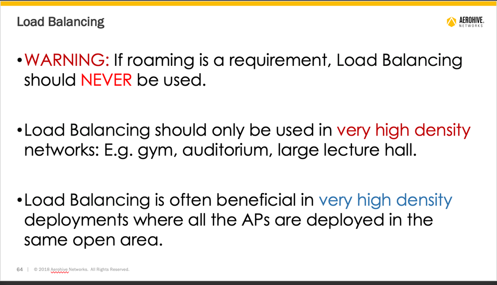

Our SE found it...
You are correct. Any AP that has load balancing enabled should be able to see every other AP with load balancing turned on, which means large rooms/venues like auditoriums, gymnasiums, etc. The online help at docs.aerohive.com doesn’t really mention that, but we go over it in the ACMA class. Here’s the slide from the presentation deck that mentions it:
rsijoria
Thanks for the response BJ, I have disabled the 11b data rates 1,2,and 5.5 for 2.4GHz(aerohive ), so essentially the default setting for the radio. The load balancing interfering with roaming, makes sense as the AP might end up not roaming and rather than trying to load balance the client.
if you can find any documentation that will be great.
