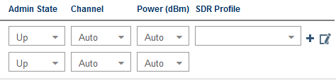

‎01-21-2019 04:22 PM
The Admin State on both radios is set to UP.
‎01-21-2019 04:03 PM
So that sounds like the radios are set to down. If you go back to edit the AP, what do you show as the admin state?
‎01-21-2019 03:59 PM
The output says, Link down.
But the Admin State on the AP is UP, the Channel and the Power is on Auto.
I just tried to set the Channel and the Power manually, but it doesn't change.
