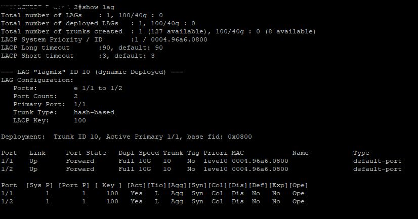

Sazon
New Contributor III
Hi Joergkost,
After I “lldp run” command. I can now see the connected device and the LAG.
Thank you so much.

Sazon
New Contributor III
Hi Jeorgkost,
I just already enabled both interfaces of connected MLX and it went up.
Here is my first configuration.
Can I verify if it Is successful LAG? how can I see the connected peer?
In VDX I can see by show LLDP neighbor, and in Summit by show fdb
Regards,
Sazon
joergkost
Contributor II
Hello,
can you post an output of some of the interfaces:
show interfaces  brief
show media
show lag brief (if any)
