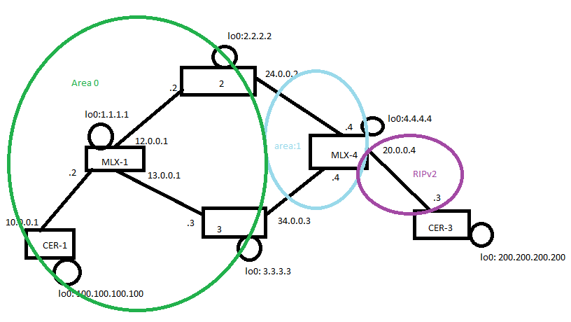

03-06-2020 10:23 AM
Hi Michael,
Here is the topology and the behavior i noticed:
I have loopback interfaces in all the routers. All the loopback interfaces are part of OSPF except in CER-3.
When I redistribute the BGP/RIPv2 routes into OSPF, the BGP/RIPv2 routes are advertised properly to other OSPF routers.
The CER-1 receives a LSA type-5 for the routes 20.0.0.0 and 100.100.100.100 network and able to ping the loopback on CER-3.
I have redistributed the OSPF routes into BGP/RIPv2 on MLX-4 following the config that you shared however, I dont see any
routes on CER-3 for 24.0.0.0 and 34.0.0.0 prefixes. These network doesn't exist on CER-3's OSPF database and routing table.
All the other routes from Area 0 are seen on CER-3.
Not sure what is missing in config but looks like the MLX-4 doesn't redistribute the OSPF routes into BGP or RIP. I have tried
this with both BGP and RIP and the behavior remained same.
The routes 24.0.0.0 and 34.0.0.0 get redistributed only when I configure the redistribution of "connected" routes into BGP or RIP.
Is this an expected behavior?
