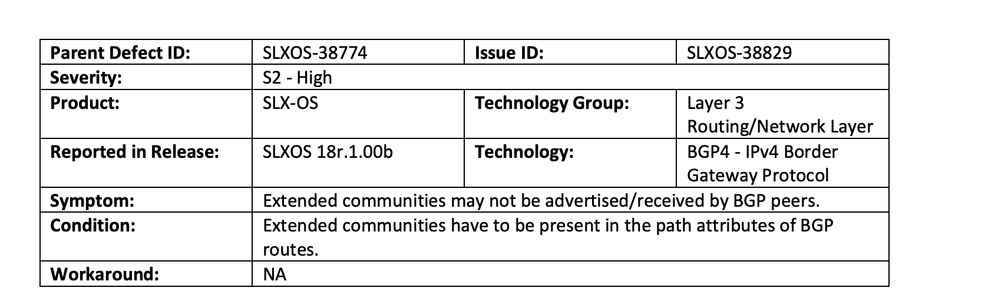

Does the SLX -01 with 17r1 have any other peerings?
Is the SLX-02 running 18r1, 18r2a or 18r2b?
Else, I would presume, that this is could be a variation of the SLXOS-38774 bug, that is fixed in 18.r2b.

Can you share some snippets from your configuration?
I do see SLXOS-38774 in SLX18r2b release notes, but this seems limited to extended.
