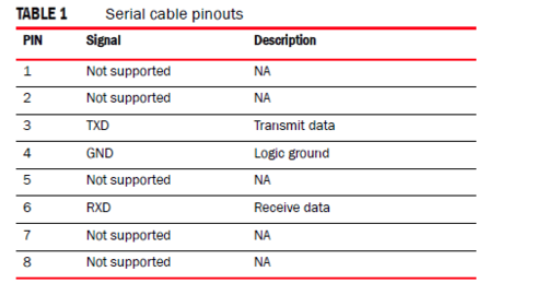

Mick_Day
7c048821e78548b2b6ed1be62d7a5982_RackMultipart20180807-105136-17yrlfb-Capture_inline.png
Here is pinouts for serial cable
Pawel_Eljasz
New Contributor II
Is there a diagram of DB9 to RJ45 adaptor?
My DB9-RJ45 cable is no good.
