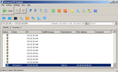

I have acquired an Enterasys VH-2402S switch. I am unable to communicate with it using console management port via puTTy (black screen/no response) or any other method. I had no idea of the IP configured in this switch. After some thought, since I acquired this switch from a network guy, who also did not know the IP, suggested I try a range of IPs in the 172.22.xx.xx range since it came from his company. Using AdvanceIP Scanner I was able to determine the configured IP address of the switch is 172.22.xx.255. Wow. This is an invalid IP I'm sure, and is preventing me access to it via CLI / ethernet cable. How do I gain access to this switch? I asked that network guy and just got a shrug and statement that I probably can't. It's almost like he knew it and wasn't bothering with it... Anyway, any ideas on how I can get access to this switch to change the IP to make the switch useful? Thnks!

Because of the Mask setting I was told from the network guy. 255.255.254.0. I confirmed the IP range they used 172.22.34.0/172.22.35.xxx. I don't know nmap but am checking it out now. Attached is how I determined the IP of the switch. Strangely it says the manufacture of the switch is Dell!

I'm pretty sure that that is the MAC of the notebook that was used for the test.
.255 is the broadcast address in the /24 network

Why do you think a 172.22.XXX.255 address is an invalid address?
With regards to gaining access - what ports are open on the switch? Since telnet and ssh are common remote access programs, what's returned from nmap -p 22,23
