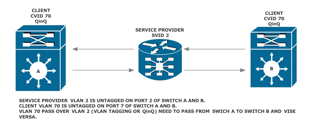

82e20c4e9e8248b89314ce138cb2b8d5_RackMultipart20160303-35833-1we1p8w-q-in-q_config_vlan_diagram.png

We need a network diagram with all the VLAN IDs that are used to check the configuration on the screenshot.

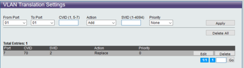

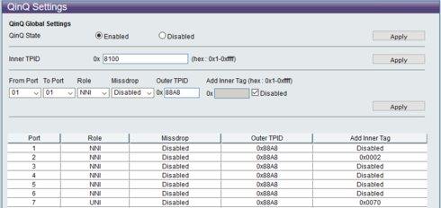

here is an image of my configuration
0a8137b180fc4459ba7a319cdfa6dd6a_RackMultipart20160302-7206-9nk547-q-in-q_config_inline.png
0a8137b180fc4459ba7a319cdfa6dd6a_RackMultipart20160302-56036-1ss9wkg-q-in-q_config_vlan_translation_inline.png
as describe in the configuration had book this is how q-in-q works.
thanks for any help.
