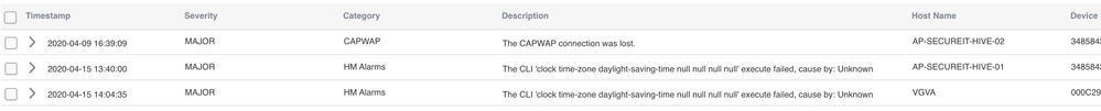

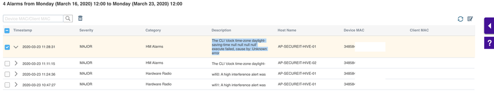

I'm getting an error while trying to update my APs config (Delta Update) from ExtremeCloud IQ:
The CLI 'clock time-zone daylight-saving-time null null null null' execute failed, cause by: Unknown error

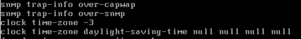

After a "Complete Update", taking a look at the "show config current"look what I got:

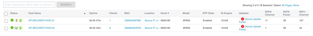

Issuing a new "Delta Update", I got the same error:

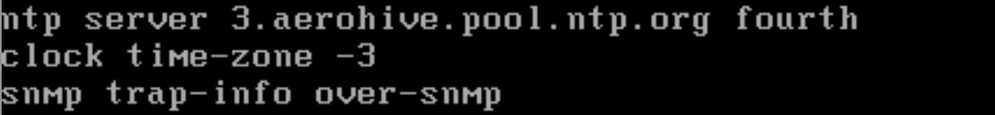

I tried to issue the CLI commands "no clock time-zone daylight-saving-time" and "save config". Taking a look at the "show config current" and the "clock time-zone daylight-saving-time null null null null" is gone :
After issuing a new "Delta Update", I got the very same error…
Looks like the XIQ is trying to apply the command "clock time-zone daylight-saving-time null null null null" which is not right…
As I told before, a "Complete Update" works fine, besides of the reboot, but it writes the problematic command in the config…
It looks like a BUG in XIQ.

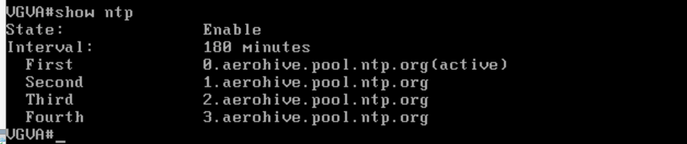

@Ronald Dvorak , follows a screenshot of the show NTP from a VGVA (same on APs):

Using a DELTA update, the issue is the same:
It looks like the XIQ try to apply in the background the cli command "clock time-zone daylight-time-saving" with NULL parameters, which is not expected by VGVA or APs (looks like a bug)…

could you share the AP CLI output for #show ntp ?
