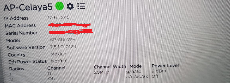

We are configuring VE6120 Small Controller (Firmware 05.06.01.0035) and adding AP410i-WR, but we can not turn on Radio 2.
We create a Site for Mexico Country, but in this Site radio 2 is not working. If we create a Site for example UK, this one works.
Any suggestion?

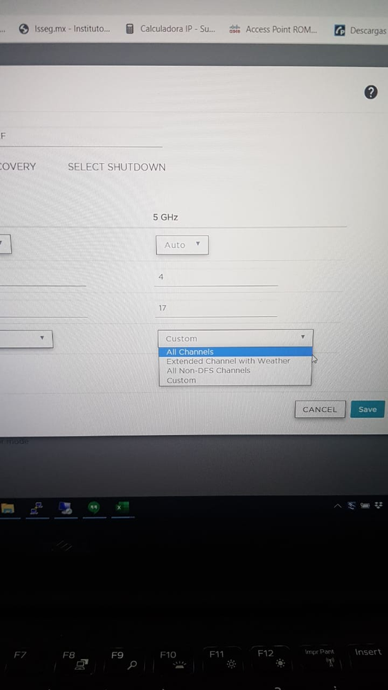

‎11-06-2020 06:14 PM
Hi Ovais.
These are the options:
I will be sending you tech-support and ap log.
Thanks.
Regards.

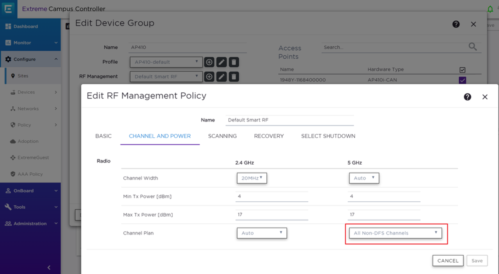

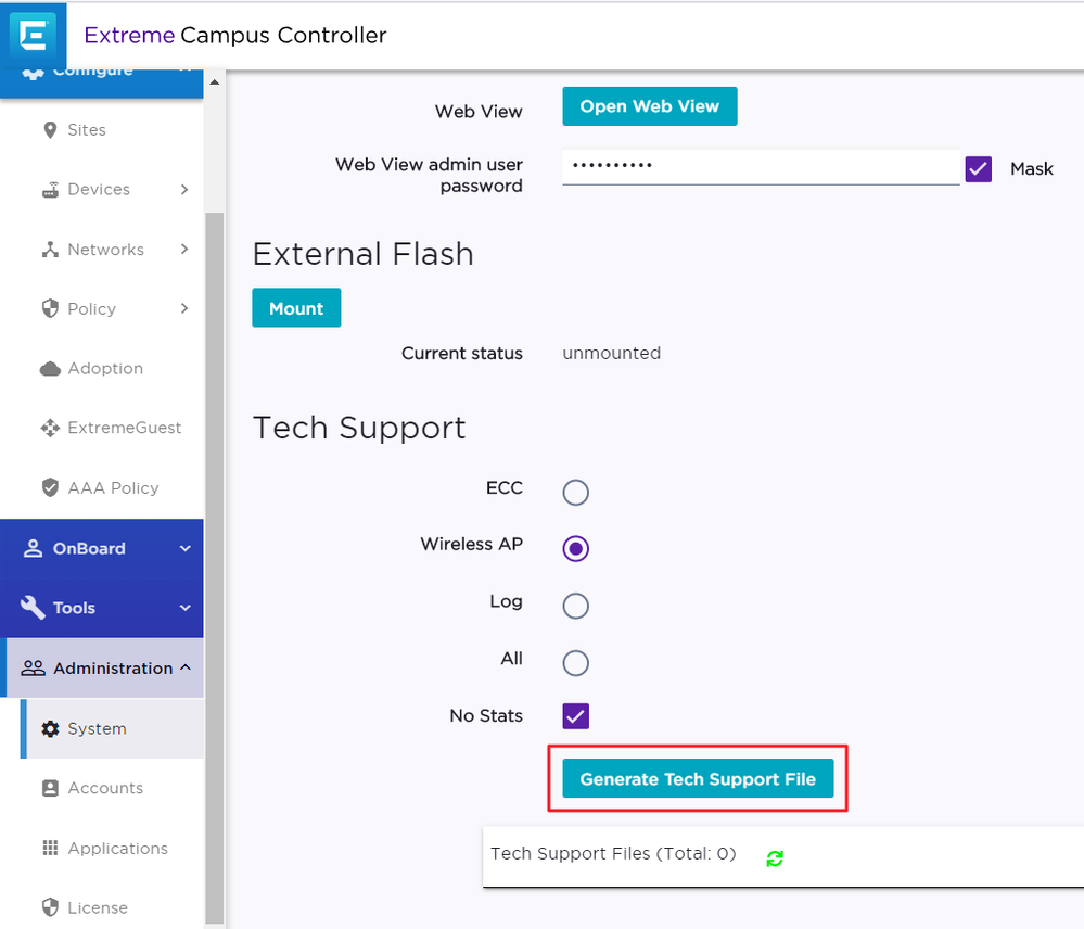

‎11-06-2020 04:57 PM
Could you check the following and let me know what you have set in this section? It is possible that radio channel settings are causing it to select a DFS channel. coul you also send the AP log and tech support from the XCC.
