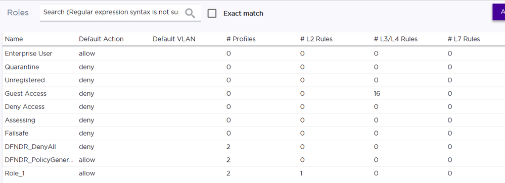

I am demoing the Defender SA201 Adapters and am having some difficulty working with the Defender Appliance. When I first started with XCA and the Defender Appliance a few months back, I had no issue creating a role in XCA, and that role then showed up in the appliance.
After about a day of this working fine, the appliance seemed to reset (it had me complete the setup wizard again the next time I logged in) and now whenever I create a role in XCA it doesn’t show up in the appliance. Only the default ‘DFNDR_DenyAll” and “DFNDR_PolicyGeneration” show up no matter what I do.
I created a test role and added it to the same two profiles that the aforementioned roles are a part of but this did not resolve the issue.

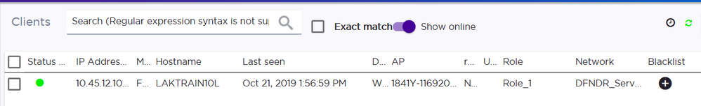

I am also having an issue where I have a laptop connected to the adapter, it is using ‘Role_1’ because I assigned it as the default for the network but the device does not show up under the protected device list in the Defender Application. It does however show up as a client in XCA.

You will notice all default Defender roles begin “DFNDR.” Any role you want to be recognized by the Defender container that you make in either the XCA or XMC GUI must begin with DFNDR for the app to recognize it.
10-21-2019 07:25 PM
Rodney you have made my day. I added “DFNDR” to my test role, and not only did that role pop up in the application, but the end device did as well.
Thank you for your prompt and helpful response!
