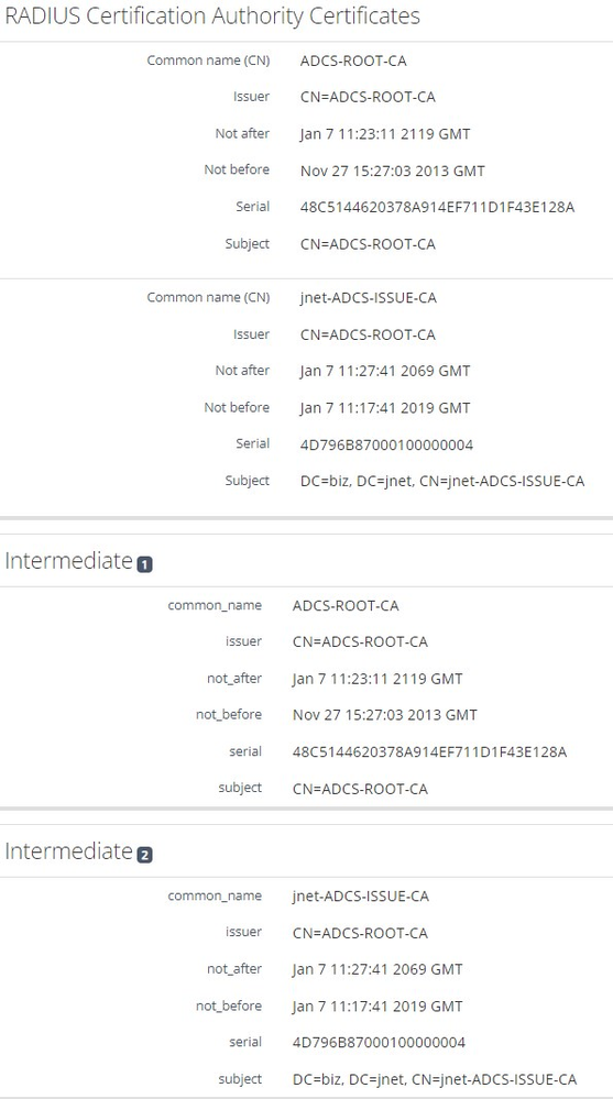

I'm testing EAP-TLS wireless cert-authentication this time. The radius debug log shows the following errors.
I have both private CA certs added to the RADIUS certificate section (Configuration -->System Config-->SSL Certs---Radius)
The certificate order is Root-CA first, Issuer/Intermediate CA second..screenshot below. The android phone also includes both CA certificates. My connection profile is set for the SecureSSID with a EAP-TLS source. The EAP-TLS source has no conditional matches and acts as a catch-all.

Is this a private CA with no intermediate CAs? Did the root CA sign both the RADIUS server certificate used by A3 and the client certificates used by clients? Or was the RADIUS SERVER cert signed by the root but the ISSUE-CA cert signed clients?
The general order:
The Certificate field will contain the CERT of the RADIUS SERVER certificate.
The Certificate Authority certificate(s) field will contain, in order, the ROOT certificate that *signed* the RADIUS SERVER certificate followed by any other client certificate signing authorities in any order.
The Intermediates will only be populated if there are intermediates in the chain for the RADIUS SERVER (i.e. Root -> Intermediate 1 -> Intermediate 2 -> Server -> Client). So if jnet-ADCS-ISSUE-CA signed the RADIUS SERVER cert it will be listed here. If the RADIUS SERVER cert was signed by a different CA it would be listed here. If the RADIUS SERVER cert was signed by the root, then it would be listed here.
