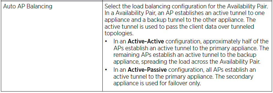

While an HA active / passive setup seems to be recommended by Extreme
I am not convinced it’s a good idea having all control traffic going to the active unit which requires both units to be sized for 250+AP, etc..

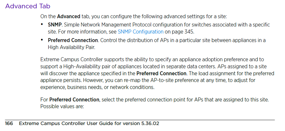

In active active you don’t control the hosting of the APs by an XCC. In Active-Passive you can play with this to force a precedence:
Both units should be sized to be able to host all the APs in case of fail-over (upgrades, reboots, etc)

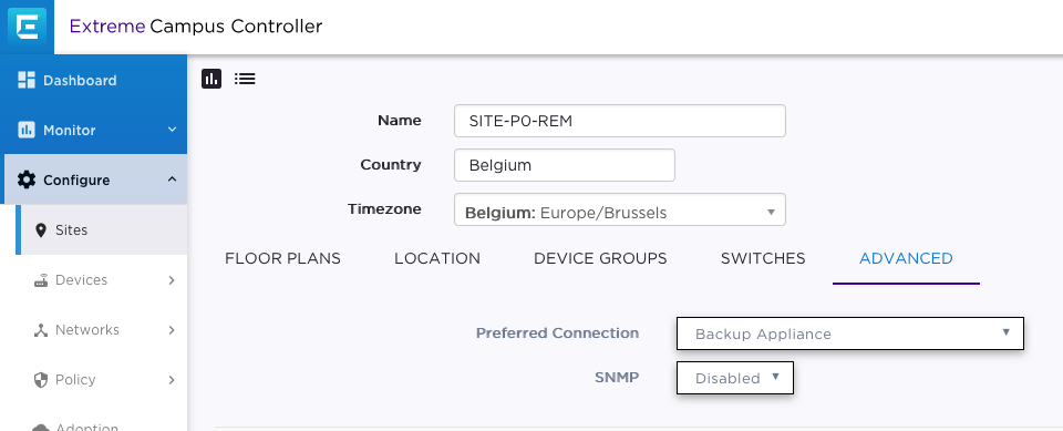

In your case (I used this also) I would configure two sites. Each site config having a preferred connection to the XCC on the same site (Active-Passive mode):
