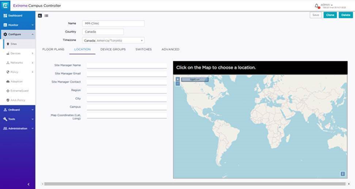

You can use “Location” tab in Site configuration to configure location/zone information, you will use this as a match condition for VLAN assignment, you can either use the name of the SITE itself or one of the following location parameters:

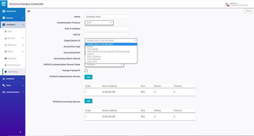

 Then, make change to AAA policy in XCC and configure either site name/city/region/ as Called station ID to the NAC (based on how granular the VLAN assignment is).  XCC will replace original Called station ID with the one you specify here while sending the authentication request to the NAC.

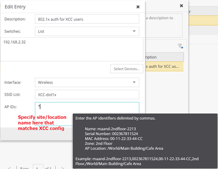

On the NAC, create “location groups” and specify the “Site Name” or whatever parameter you used as Called Station ID. NAC will match this with the incoming Called Station ID.

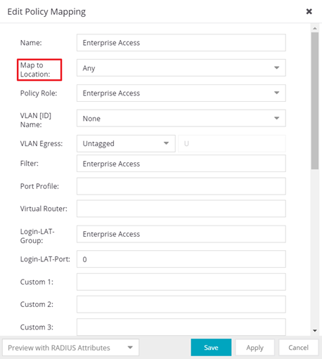

As for the Policy Mapping, you can create Policy Mappings with the same Role name and specify different “Map to location” value for each of them. This will allow NAC to determine which VLAN to return based on location while still using the same Policy Role.

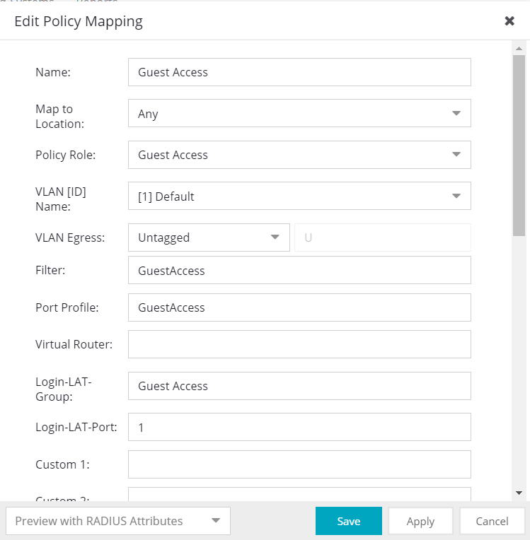

Maybe I wasn't clear, sorry, but I've just configured something like the screenshot provided, and already used it on EXOS and IdentiFi several times, but never with XCC. The goal is really to use the same Role, but assign different VLANs based on the NAC rules, keeping the policy domain consistent across wired/wireless. Passing just the policy in the Filter-ID is not enough, because we don't want to have "Contain to VLAN" Roles, because we use different VLANS, depending on the environment (wired/wireless), departments, AD user groups, etc… But the VLAN attributes seems to be not working… I've ran a test on an old IdentiFi controller, and it works…

Unfortunately it's not the case (and I've tested this scenario and selecting the VLAN on the Role make it work perfectly, as soon as I don't pass any VLAN attributes. If I set the VLAN on the Role and send the VLAN attributes, it doesn't work as well). The customer, as stated before, want to use the same Roles, but applying different VLANs depending on the NAC Rules they defined…

I'm using direct integration with NAC using Configuration > AAA Policy.
