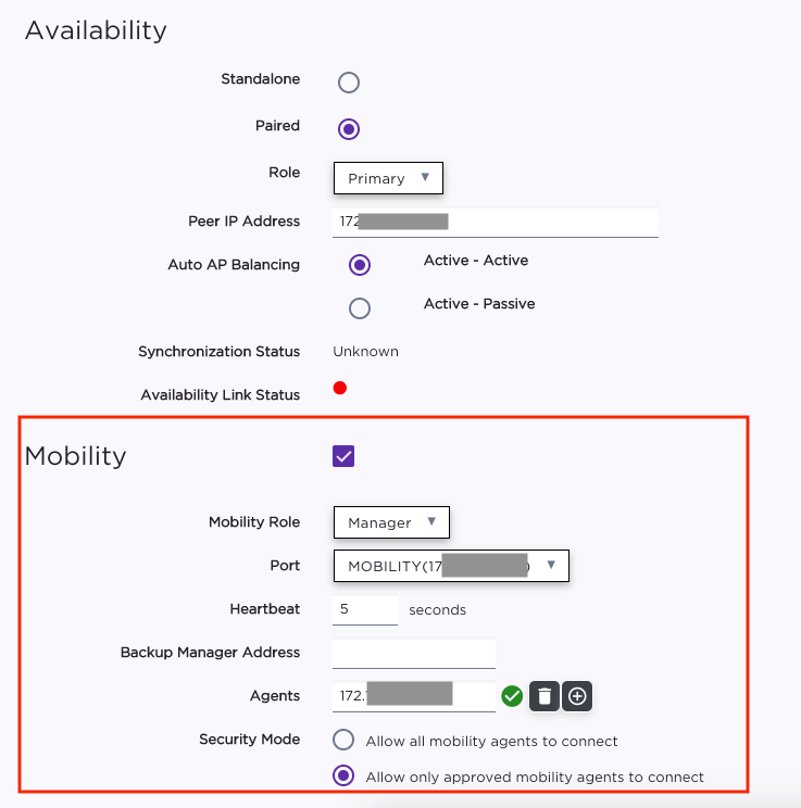

  1. Mobility
It's a bit obscure, because the documentation and help shows almost no info. The Mobility configuration seems to be set, by default, to AGENT, so the config shown on GUI is just for that role.
But I found that if I log on the XCC CLI, and change the mobility mode to MANAGER, the new options are shown on the GUI as MANAGER, with the full options…

All these configs need to be "enabled" through CLI… WLAN Remoteable and changing the mobility mode to Manager…
By default (not possible to configure to other role in GUI), the Mobility role if AGENT.
To make the GUI shows the Mobility config as Manager you need to login on the XCC's CLI and run the following commands:
XCC01.secureit.com.br# mobility
XCC01.secureit.com.br:mobility# mrole manager
XCC01.secureit.com.br:mobility# apply
And we got the options enabled!

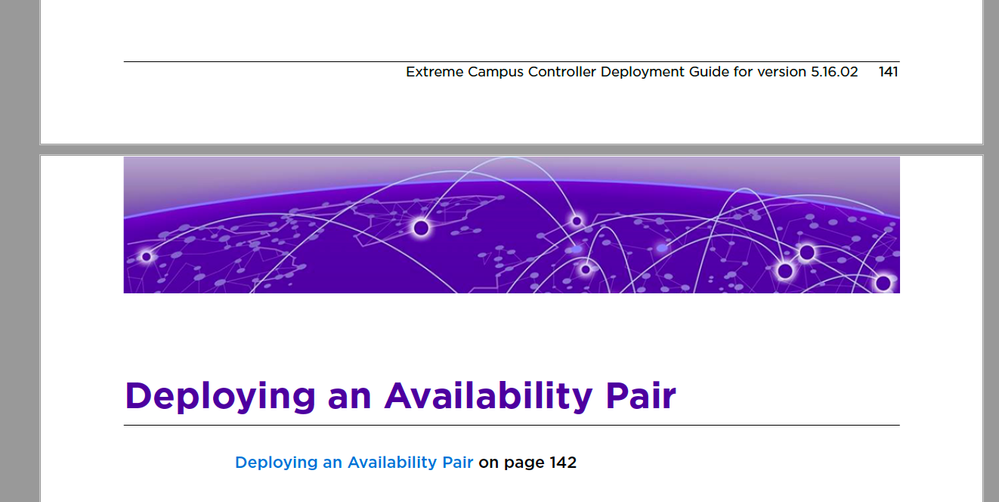

With a pair in HA, you don’t need to setup the mobility.
They’ll replicate the common config objects.
I never used the “remotable” flag.
What has to be set locally is some specific parameters.
I used to config the XCC from the XMC in a policy domain (roles, VLANs).
I’m managing an XCC cluster with almost 2000 APs with no issues concerning the HA.
Have a look at the deployment guide:
