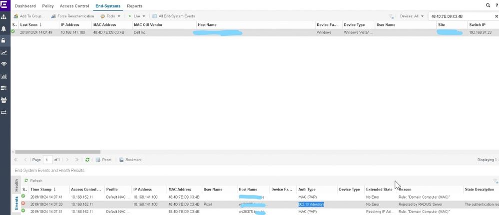

The screenshot below shows a 802.1x client being rejected as intended. The authentication is being proxied to an external RADIUS server.
What then seems to be happening is the end-system is getting on the network via MAC auth, and then hitting a rule as designed. But what is really meant to happen is the reject is meant to mean a reject when authenticating the first time around until the port state changes, thereby stopping access based on the failed 802.1x authentication.

My understanding here might not be completely right, but I’m expecting EAPOL traffic between the client and the switch, and on a RADIUS reject from the Authentication Server to the Authenticator (switch) the port should be denied access, and this looks like what seems to be happening from the screenshot and wireshark captures taken from NAC.
So I don’t understand if the supplicant is configured for 802.1x then only EAPOL traffic should be sent between it and the switch, how is able to pass traffic for the switch to be able to do MAC auth - does that mean this is a client issue, if so, being a Windows machine, what setting might correct it?

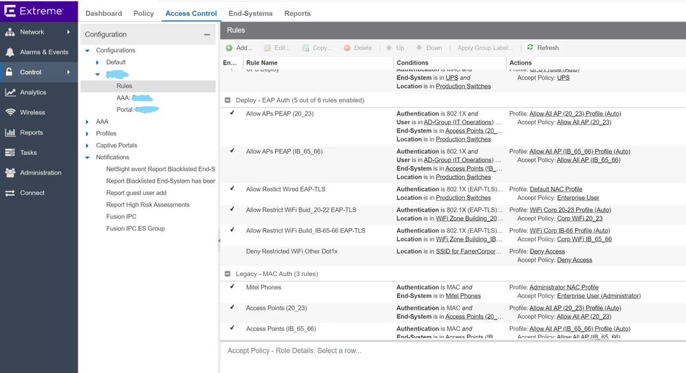

Think the customer was trying to be a little more blunt with the configuration, because they are using RADIUS proxy they wanted a reject from their RADIUS server to be a reject and stop there. As the reject is coming back at the authentication stage it doesn’t then pass to the NAC rule engine to do what you mentioned above.
Suggested a couple of things i.e.
- Put in an authentication rule to allow local authentication and then pass directly onto the rule engine.
- Have the External RADIUS server return an accept with a ‘Filter-ID’ that matches a deny rule.
- Disable MAC auth on the port (believe this isn’t an option in their case)
Maybe there is a couple more ideas?

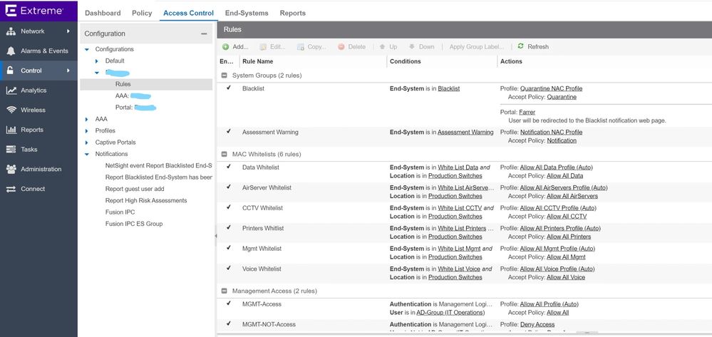

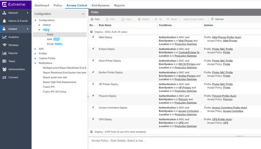

So I can hopefully contributing something helpful back too, what you describe is typically how I would configure things, a separate rule for each MAC auth device. With MAC auth being a weaker authentication I will apply an explicit ‘deny all’ and then just allow only what its trying to do.
I add whitelists in to bypass the deployed rules, just in case something doesn’t work because of a missed rule restriction. Also roll out piecemeal by just added switches to the ‘Production Switches’ as and when each area is moved. If they didn’t hit that they would just hit the catch all rule.
Once all migrated I either changed the catch all rule to deny traffic, or put them onto a guest network.
