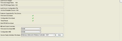

I am trying to configure an archive in inventory manager to backup the wireless controller. I did all below but it is not working:
1- configured the SCP options in inventory manager with the netsight account
2- configured the image information in inventory manager for wireless controller as below
note: I tried to use "controlled by device type" for configuration MIB, but also it did not work and the error message is (Device Reported - There is no such file or directory)
Anyone have an appreciated advice?
PS. I can access the wireless controller well from netsight and I can execute commands over SSH.
Thanks
Husam
- firmware MIB : script
- configuration MIB : script.
- device family definition: entrasys wireless controller -SCP
Thanks
Husam

Thank you all. It is solved.
The problem was that Netsight for windows does not include any FTP or SCP server.
I have installed filezila and did the required configuration related to account and directory in the option-file transfer-FTP. It is going well now and the config file is stored along with other devices in same directory.
Below link guided me to find the problem

Husam, thanks for your reply.
It was resolved, in my case I used the home FTP server.
In the FTP server was created a group and I associated one called inventory account and also a directory for this user.
In the inventory manager within the FTP options, I put the credentials of User created within the home ftp server and it worked perfectly.
Recalling that also what we need to change is the type of protocol used, instead of scp (default) put the FTP method.
