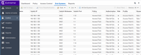

StephanH
Valued Contributor III
Hello Byron,
there are different views to see the switch port. Here is one:
da9912be59724d329c17605a964797d1_RackMultipart20180926-127327-5np9f6-image_inline.png
and here is another one (and there are much more)
Regards Stephan
