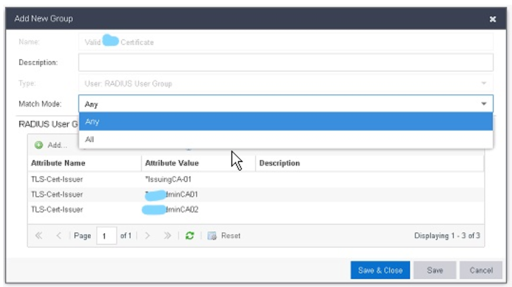

So individually I can configure the ‘Or’ and ‘And’ compound arguments via the ‘User Groups’ section shown in the image below. I can set the ‘Match Mode’ to ‘Any’ which is equivalent to ‘or’ for one group and ‘All’ being equivalent to ‘And’ for the other group.
This would though create two separate user groups, one with the ‘or’ and one with the ‘And’

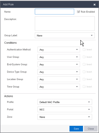

The issue I have is creating the rule that joins them both together with an ‘And’ to match the full statement above.
See image below. With only a single instance of the condition ‘User Group’, how do I achieve the ‘And’ to for the two User Groups?

After re-reading my response I thought I would re-write to make it a little clearer:
So if I take the original and / or statement, which effectively looks like this:
(A or B or C) and (D and E)
What I am saying is that I could achieve the same thing by creating the following groups:
Group 1 / Match All (equivalent to ‘And’)
A+D+E
Group 2 / Match All (equivalent to ‘And’)
B+D+E
Group 3 / Match All (equivalent to ‘And’)
C+D+E
I now create three separate rules that that use each of the groups. Think that will effectively achieve the same thing as the one statement does at the beginning of this thread.
Not sure if there is a better way of doing it, but that’s all I can come up with at the moment.

Think I’ve just figured a way to do this. Not quite as elegant but only thing I can think of.
Basically I create three separate user groups.
I take one of the ‘or’ statements, create a user group and select the match mode ‘All;. The add that two ‘And’ statements.
I do the same for each of the ‘or’ statements.
Then just create three separate rules that include each of the three user groups!
That should equal the same thing I believe.
