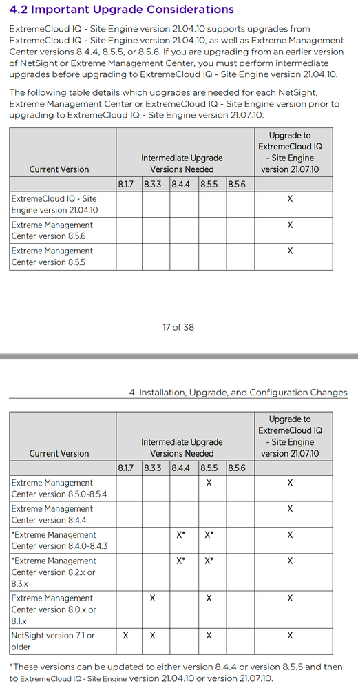

Are there any guides on how to upgrade or migrate Extreme Management Center to the new XIQ-SE?

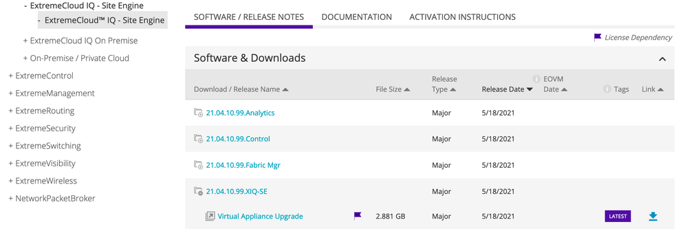

The upgrade to 21.4.10.99 is not tested from 8.5.6. as 8.5.6 was released after the 21.4.10.99.
If the customer is on 8.5.6 and wants upgrade to XIQ-SE then there are two options:
- wait for 21.9
- ask GTAC for 21.4.11

Hi Byron,
From technical point of view, it is like a upgrade for the XMC.
It is described in the release notes:

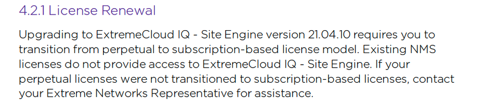

From a license point of view you should check that with you local sales representative.
As wel in the release notes:
