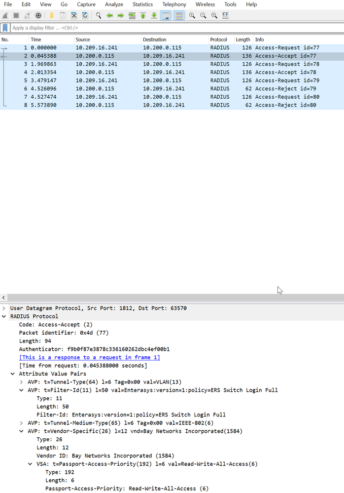

Believe the important step is to make sure the “Passport-Access-Priority” attribute is set. The packet capture below from NAC shows it is sending back the RADIUS accept with the attribute set to 6:

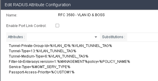

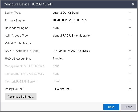

I created my own custom RADIUS attribute as was previous using the ‘RFC 3580 - VLAN ID” and could not see one that used the same values plus the one the article talked about. There is one pre-canned ones that come close but was not exactly the same:
The other thing that is slightly different is the article mentions setting it to “Management Login”, but I need to do RFC 3580 VLAN ID for 802.1x authentication, so have it set as per below:
