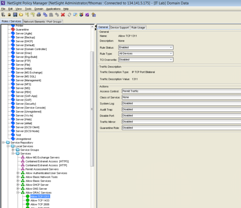

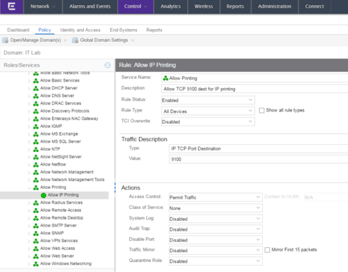

It's a feature for any service rule if you're using Policy Manager and Nac in conjunction.
Policy Manager Thick Client
Netsight Oneview[6.3] / Extreme Management [Screenshot from 7.0]
‎06-01-2016 07:03 PM
Hello, I wasn't able to find that menu 😕
Can you tell me where it is ? 🙂
