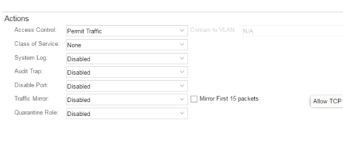

‎06-01-2016 07:03 PM
						Another way to skin a cat,
Within Policy Rules
There are actions for either System Log or Trap when the rule is hit. You can read about policy rule hit accounting for a bit more details.
Anyways, from that event, you can use alarm manager to launch a script from the netsight server which could be ssh/telnet to your device and make the config changes.
