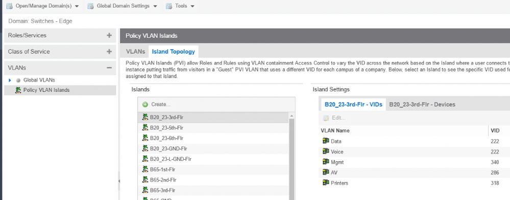

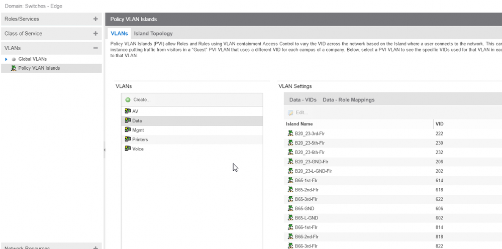

In this scenario making use of VLAN islands in XMC (policy) allows the dynamic allocation of different VLAN ID's for the same purpose i.e Data, for the various different locations.

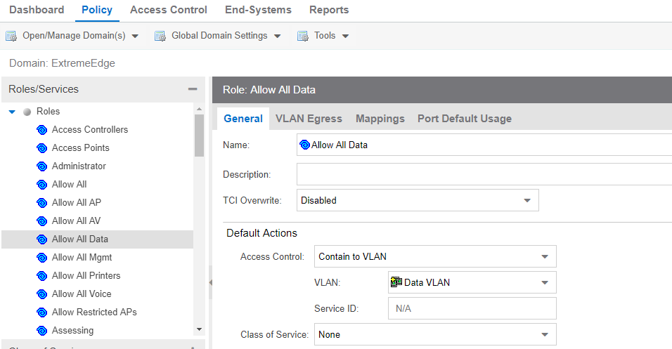

In the screenshot below there is a function in 'Roles' to assign a 'Service ID', the issue is the 'Data VLAN' given below is dependant on the location / VLAN island configuration. So effectively the actual VLAN ID for Data will be different for each stack, would that require a different SID for VLAN therefore, or does this not matter?
Below is where the VLAN to SID is configured in policy, this I have use with EXOS and VSP switches and NAC, which worked well:
Here is an example of the VLAN island configuration that I am questioning the use:
