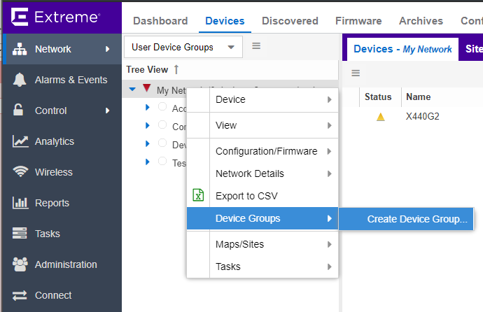

you'd create a new device group...

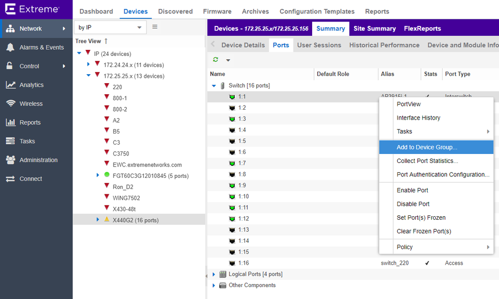

Then add the port to the device group...

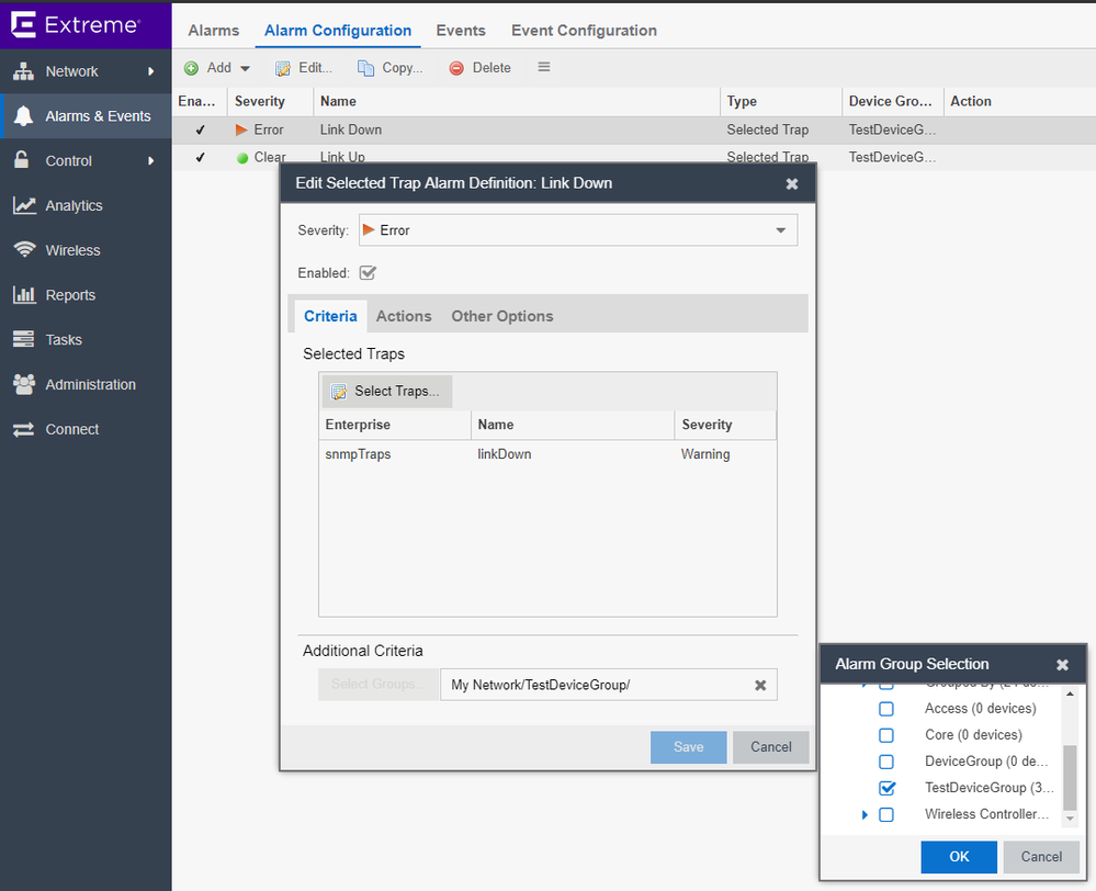

And then in the alarm select the Device Group as a Additional Criteria.
In that case you should only get a alarm for a link down if the port is part of this Device Group.
