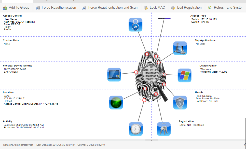

Regarding MAC-to-IP and Health I believe Zdenek (in similar thread) and I covered the topic fair enough for a sneak peek. Regarding Access Control - you have ERROR state of the authentication. You should try to see End-system events, see the possible error reason and troubleshoot. Have a look here as well: https://community.extremenetworks.com/extrememanagement-230297/802-1x-identity-what-is-it-7823134
Once you have 802.1X authentication working 100%, you should see the username.

Here is the fingerprint of my end-system

Could you please show the fingerprint screenshot with obfuscated sensitive data like username here?
