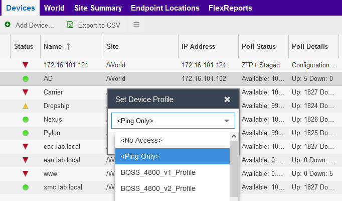

Hi Kuba,
Would device profile “<ping only>” work for you instead? It’s more frequent but just based on ping.
