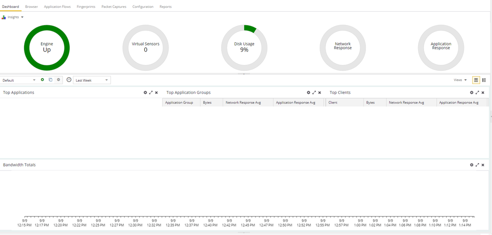

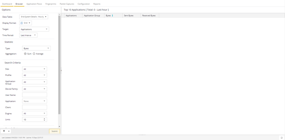

I am experiencing an issue with ExtremeAnalytics where the application flows tab is populated but the dashboard/browser tabs do not show any information on the current state of the network, as if the flows were not being processed for visualization.
I have already checked the docs, as well as all related posts here to no avail. Here is a breakdown of the steps I have followed:
These are all the steps recommended to other users experiencing similar problems. What may I have overlooked?
Thanks,

Can you check that you have configured endpoint locations with the subnet range you're tracking?
XIQ-SE --> Network --> Click on the Site --> Endpoint Locations

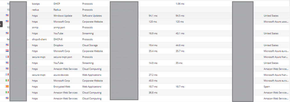

Do you see data under the "Application Flows" tab? Does it have application and network response times?

I have followed the steps in the troubleshooting guide and everything LGTM. The ACLs for ingress/egress telemetry are configured, as well as SFlow for all ports with a sample rate of 1024. The collector is set to the the Analytics Engine IP on port 6343.
As for the site, there is currently only one site configured (/World) for demo purposes. All the switches are configured to be in this site too. You can see that flows are actually being extracted and fingerprinted, as the services that appear there match with the connections being established. The network and application response times are also displayed (although not for all flows).
I am wondering if there is a minimum requirement on the number of network devices / endpoints to populate the dashboard. Currently, one switch and endpoint are being used.
