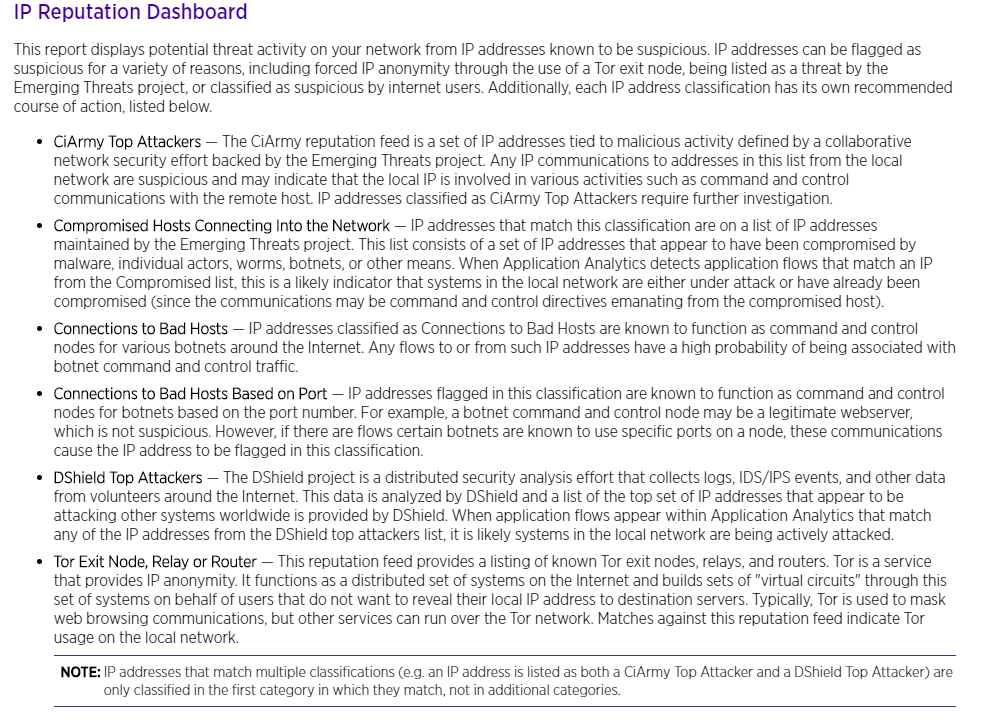

Hi Martin,
if you check the alarm config you'd see that the alarm is triggered by "reputation threat detected".
A search in the XMC online help (put in the XMC IP) brings you to the "IP Reputation Dashboard" section.
https://:8443/Clients/help/content/oneview/docs/analytics/analytics_tab/dashboard/c_pur_analytics_tab_dashboard.htm?#IPRep
For me it looks like that the 222.222.222.222 is on the list of untrusted IPs (because it's from China ?).

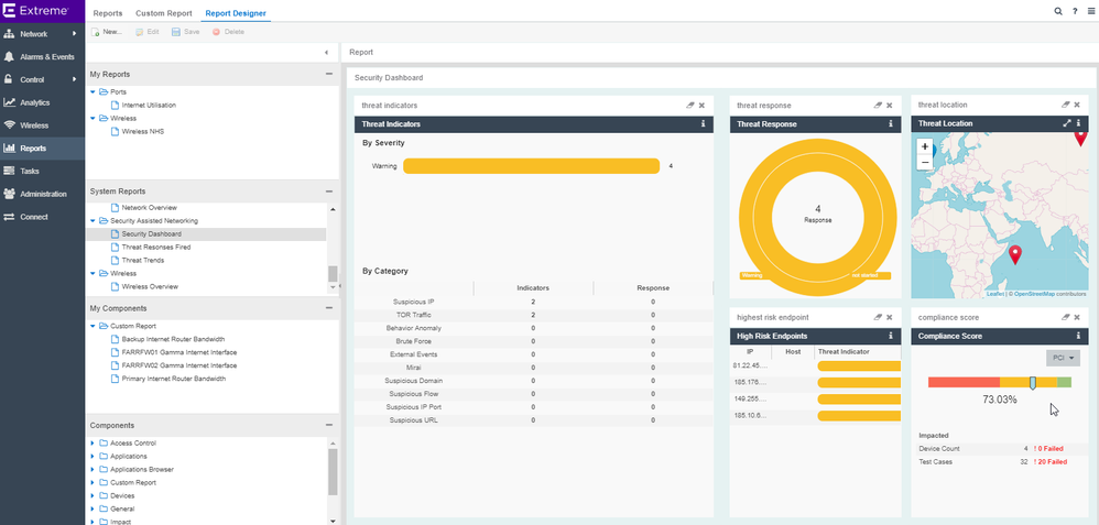

Added this another post, but just repeating here for consistency:
https://community.extremenetworks.com/extrememanagement-230297/manage-suspicious-ip-et-continuous-ev...
I've created this dashboard through the report designer, which I believe gives me the detail in what the Suspicious IP-ET events are:

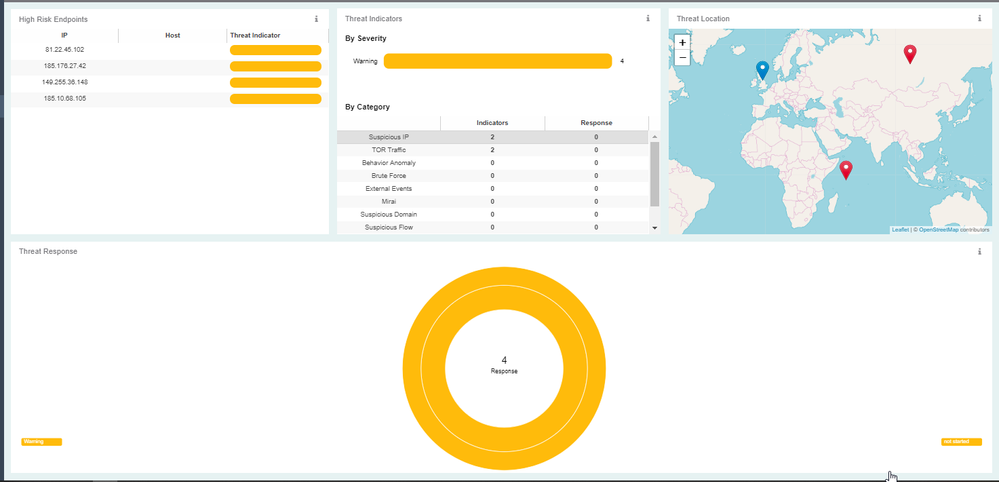

And pre-built one:

Ronald_Dvorak
Honored Contributor
Hi Martin,
