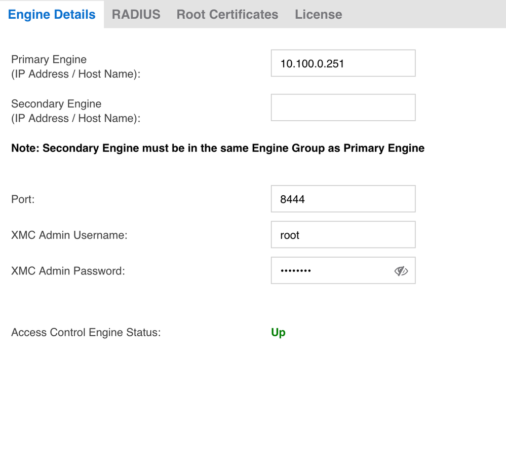

Rodney_Lacroix
No, as labeled that is correctly supposed to be the XMC server password.
The shared secret tab is for the gateway (on the shared secret tab) if using an Access Control Engine for authentication. The NAC password is not used to communicate to the engine, so this labeling is correct.
Use an XMC admin account that has Guest & IoT access, per the help and documentation.

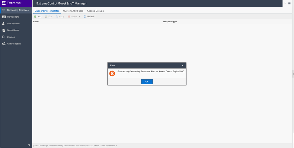

Hi guys,
I'm trying Guest & IoT Manager on lab and it's not working as expected...

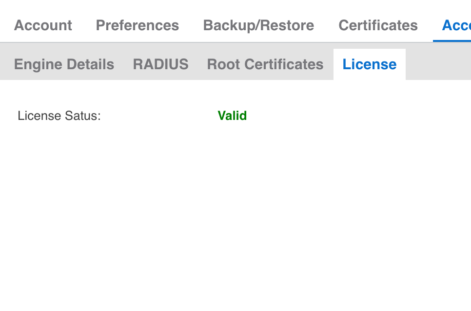

Just like Ronald's screenshot, it shows Control engine as UP and license as VALID:
But when I try to configure it, it shows an error (as attached) "Error fetching Onboarding Templates. Error on Access Control Engine/XMC"
Taking a look at G&IoT logs, i got: error
Error fetching Onboarding TemplatesStatusCodeError: 500 - undefined
Looking at the XMC server log I got;
2019-02-21 11:33:58,646 ERROR [com.enterasys.netsight.tam.server.web.rs.GimTemplatesRSServiceImpl] GIM Domain is NULL
What am I missing??

Thanks Rodney,
could it be that the following is also not correct or I'm reading too much into it.
My XMC and NAC have different pw so I've used the XMC one in the below GUI as the field is "XMC AdminPassword" - it should be the NAC pw correct !?
