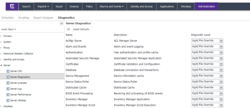

In a deeper dive sense, is to turn up logging (Should only do temporarily). There are a few different diagnostics that can be turned up.
c091d5e3a3cb4cfda3175d8a8876b167_RackMultipart20150408-8344-1ljrfaa-Inventorymanagerdiag_inline.png
The ones that are useful in this particular case would be: Inventory Manager, Inventory Manager Script, Telnet/SSH command Shell.
