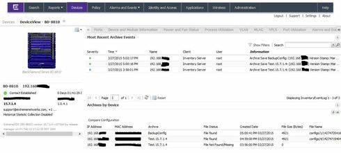

Have you tried with
Extreme XOS - TFTP ??
I have a BD8810 (with VR-MGMT) with TFTP is working well
